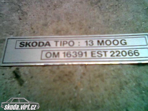

rsvancara
Maybe EST is bodywork "type" code, VIN is (whole) car "production" code on car bodywork. So it can be different :-)

txl
Ok but as I said the car has also the regular VIN plate and the VIN is different from this EST number.

rsvancara
As say petr s, EST is car bodywork (chassis) code :-)

txl
Thank you. And what about EST - any idea what is it?

-> txl:
TIPO is typ in Italien language
13 is 130 engine,
G is Rapid (Garde)
OM is probably Italien homologation
Car is maybe for Italien market, but its vent some way to Bulgary.
13 is 130 engine,
G is Rapid (Garde)

boris1 - zrušená registrace
OM je italské schválení.

Podle mě tipo je znak typu to znamená 130
OM je vývozní číslo
EST je číslo karoserie
VIN by měl být asi TMB13MOOG22066
OM je vývozní číslo

Kočislav
Napadá mě, jestli to tam nelípnul prodejce. "Tipo" zní tak trochu italsky, třeba to bylo původně dovezené do Itálie a prodejce si nějak interně značil jednotlivé typy aut. Toť má fantazie, kdyžtak to případně někdo schopný přeložte

txl
I'm from Bulgaria but Skoda Rapid was not exported to Bulgaria so probably it is brought here second hand but I don't know the history of the car. It is Rapid 130 1987.

-> txl: This is not regular plate. Where are you from?

txl
Hello,
I think this plate is not a regular one for the Skoda Rapid, is it? The car from which it is has the standard plate with the VIN but also has this in addition. Does anyone know anything about it?
