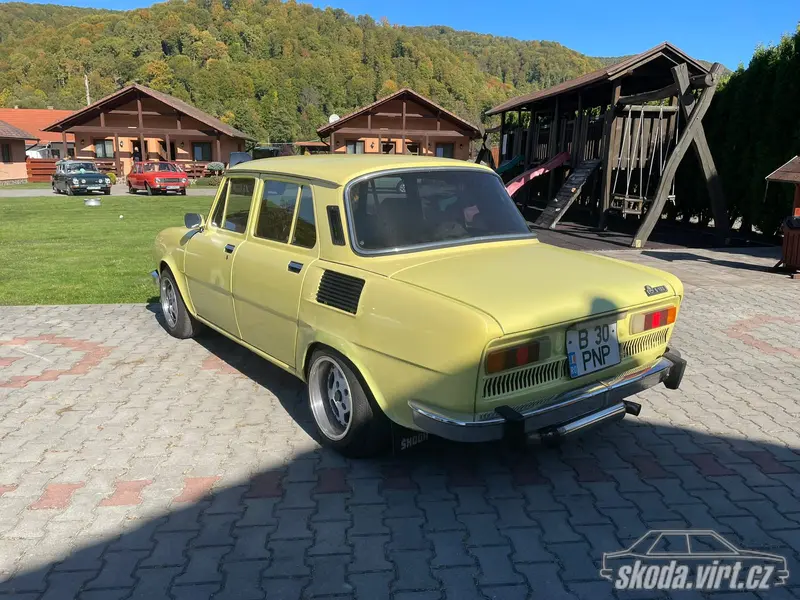

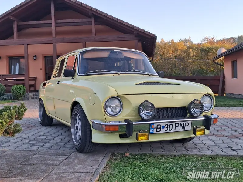

Skoda S100-1975 , I am the second owner!

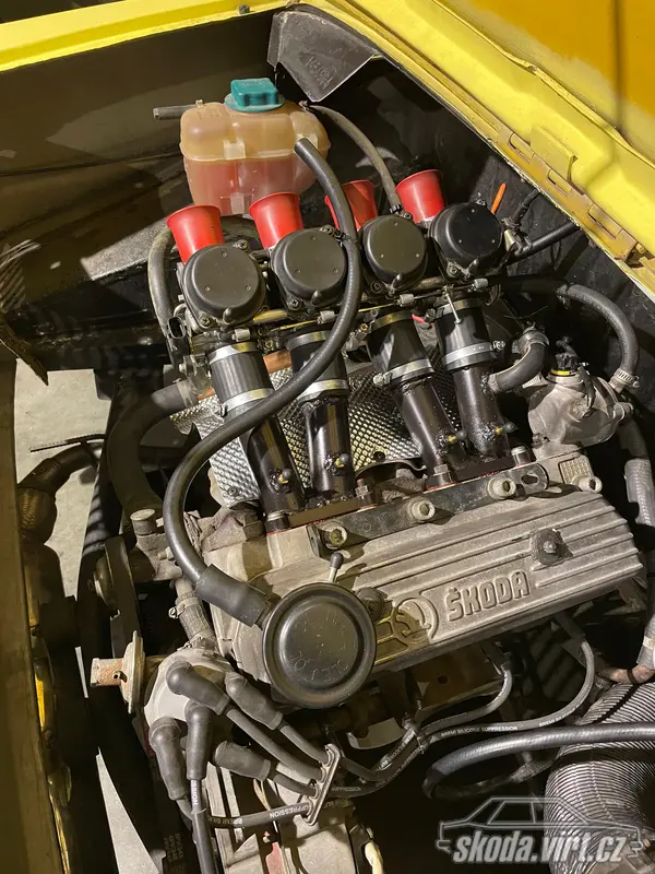

Engine-781.135M -AMG, Mikuni individual carburetors
Increased compression ratio, single springs on the valve, cylinder head porting
Felicia starter with reducer
Gearbox 5 speed- 3.90 with back system from Rapid 130.
Brakes: Front all system from Rapid 130 with 4 pistons, Back Caliper VW with pads, disc VW polo
All of the wheel hubs modified to 4X100 PCD
Springs: back Koni spring yellow from 130LR - front original 130L(soft springs)
Shocks: back Bilstein gas Ford Escort Cosworth(Minor modification) - front Mitsubishi Pajero 3.0 V6 with hardness adjustment
Exhaust: Citroen C1 modified (So it sounds like stock)
Wheels: RSL Cult 14'' 4x100
Tires: front and back - 165/70/14
